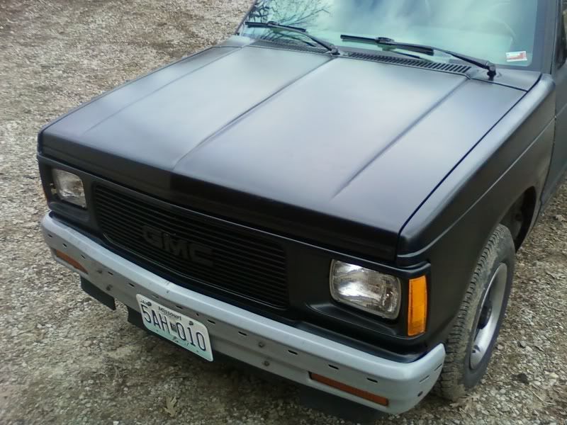

    Sanded painted installed front end-

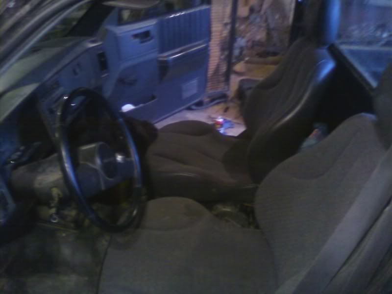

    Cavi seats going in today and new passenger door and door panels.... updates this evening ENJOY

    its s10 but the gmc grille looks a TON better. going to get a badgeless grille eventually. but for the mean while. it will do.

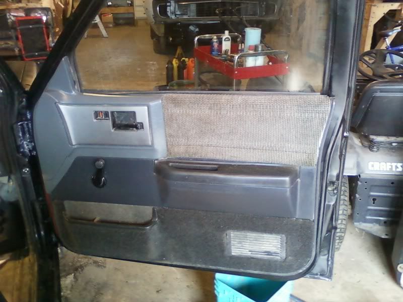

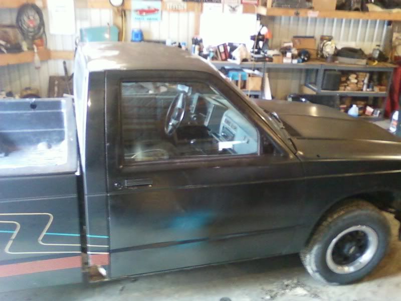

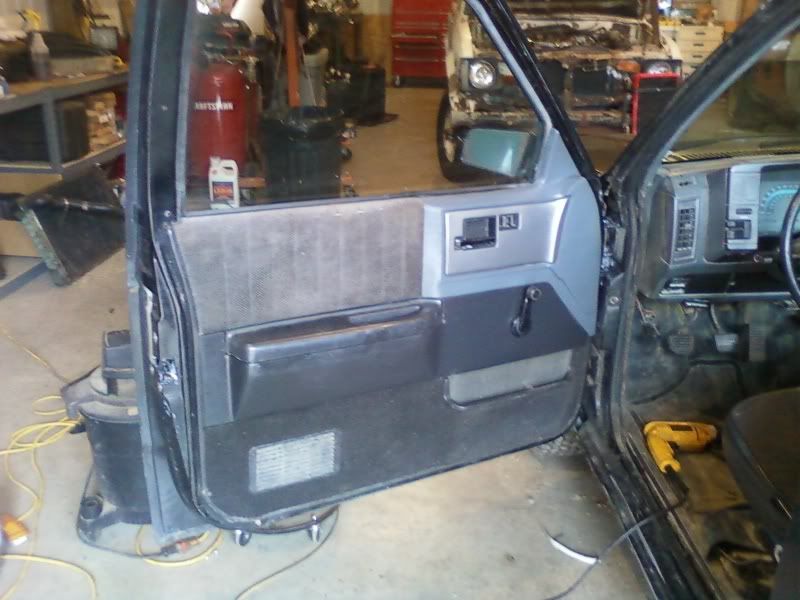

    put new door panels in and a new door ......
    old door ..... RUSTY

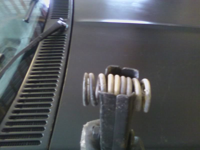

    door spring removed

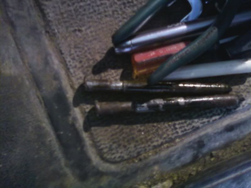

    two door pins removed
    And then a doorless s10
    New door installed
    Driver side door panel installed
    Passenger side door panel installed
    MONEY SHOT !!!

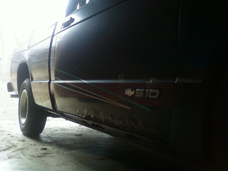

    BTW i intend to replace the cab corners and rockers here soon. just before someone states the obvious , the rust is EVERYWHERE up here.

    Great work, looks 100X better. Those door springs are a PITA to get back in with out that tool.

    oops forgot to post the Cavalier seats....
    for those who are interested , the seats did bolt up. i had to turn around a bracket and bend them on both sides and a total of six holes to get the seats in there ....
    so where ever u see " cavalier seats bolt up" on the net. They lie. Hard.
    over all - well worth the 20 bucks i paid for em. were a pain to get in. but glad they are in now.

    thanks guys. the seats do bother me a little because the sit a lil high i did some research and i was suppose to use the s10 bucket seat brackets. but the only problem is the steering wheel is a bit too close to the seat. and i plan on getting a after market steering wheel any ways. so. oops but not really.

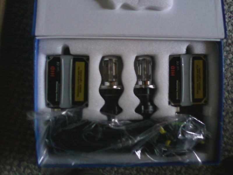

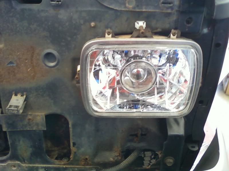

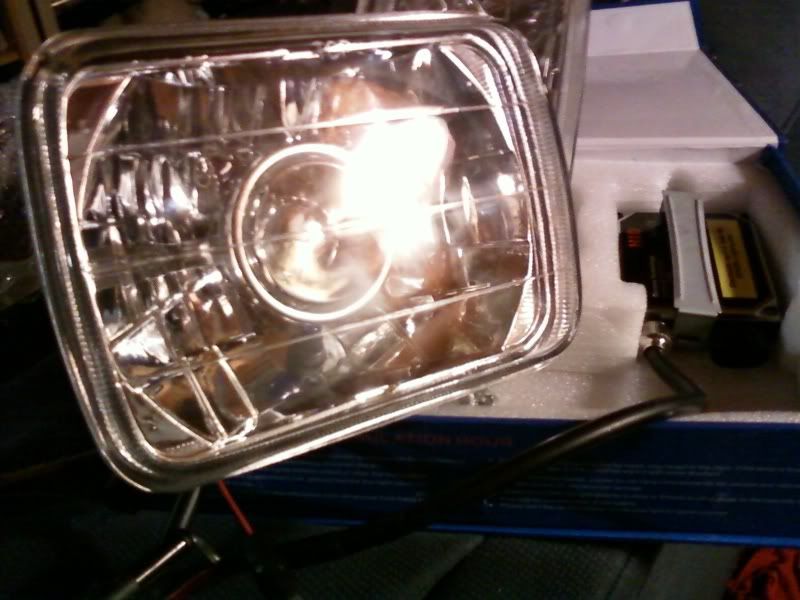

    Headlight assembly's came in too late today to put in but still took em outta the box and played with them...
    i went with the most oem looking projector i could find. i always ran oem headlights in the civic that i had hid's in so. thought i would try this. hopefully. it is a good investment if not, head lights a freakin cheap yo.
    should have them in tomorrow or sat..... teaser!

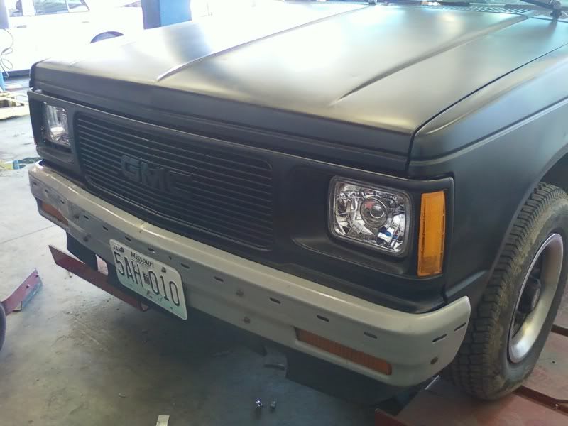

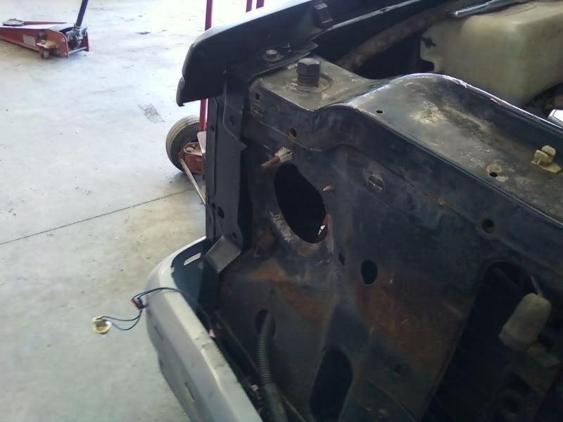

    Head light and HID install
    grille-less yet again and missing head lights ?
    headlight installed
    headlights and grille back installed
    HID's
    thats my last update for awhile i think. lol. at least a month. anyways again thanks for all the positive comments !!

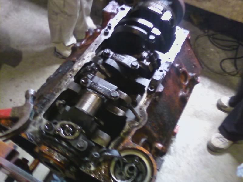

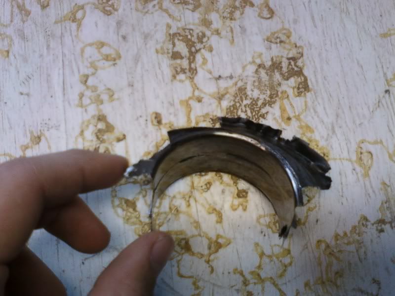

    finally had a time to take a peek at the 350 i was hoping was in good shape to build. got it for free so there were slim to none chances.
    spun a rod bearing but me and my dad measured it out and the factory size is 2.100 and the size of the good rod journal was 2.099 and the spun journal was 2.097
    and the only crazy looking damage is the rod bearing. OUCH.
    anyways should be dropping by the machine shop to see what they say for sure on the crank still being good.
