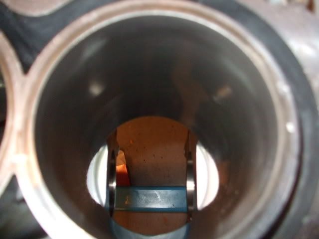

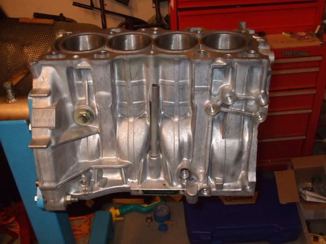

i got the block back
it was blueprinted, balanced and honed to 81.5mm.
i was told it wasn't bored at all he just honed it all out to that size. took him 8 hours.
here are some pics of it.
http://i147.photobucket.com/albums/r...0/DSCF0452.jpg
http://i147.photobucket.com/albums/r...0/DSCF0453.jpg
http://i147.photobucket.com/albums/r...0/DSCF0454.jpg
http://i147.photobucket.com/albums/r...0/DSCF0457.jpg

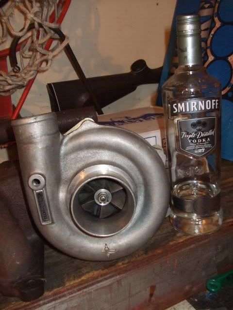

the snail
http://i147.photobucket.com/albums/r...0/DSCF0459.jpg

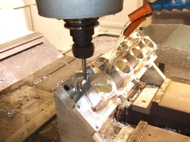

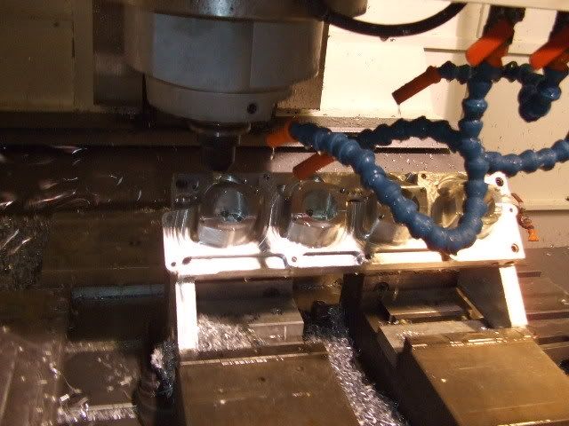

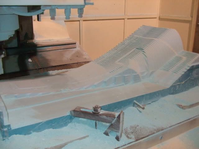

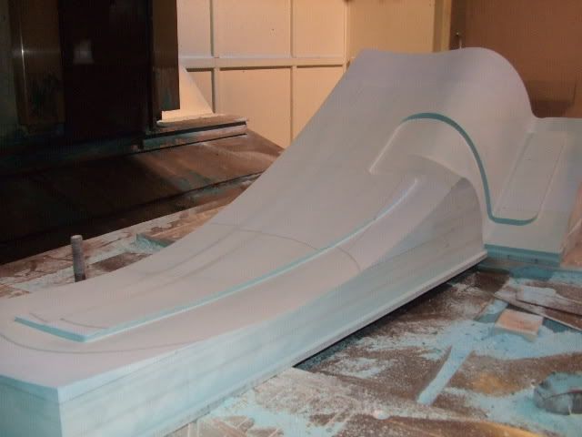

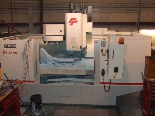

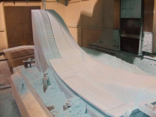

and a couple shots from work(i was bored)
http://i147.photobucket.com/albums/r...0/DSCF0313.jpg
http://i147.photobucket.com/albums/r...0/DSCF0317.jpg

u should of least sleeved the block or even put a block guard...imo
im pretty sure they will be fineQuote:
Originally Posted by Da_unknown
probably wont see over 350hp
around 300 daily probably.
ive seen plenty of people go bigger and be fine.
thats cool man...

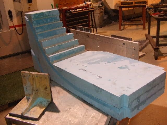

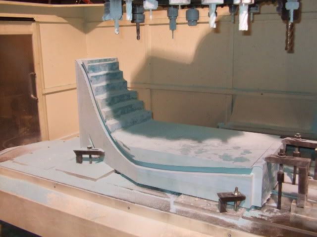

What do you do at work? That looks pretty cool.
machining, thats some cnc mill work.
i mostly just help with it not the brains behind it.

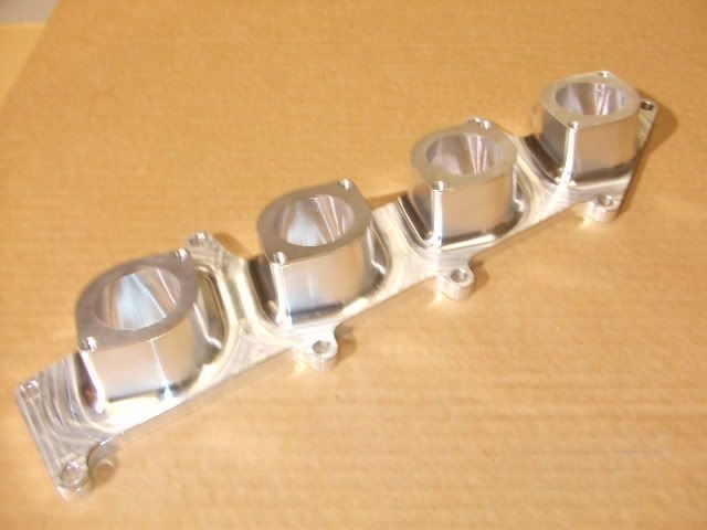

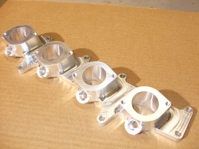

btw is that cnc flange you made goin on the setup?
thanks manQuote:
Originally Posted by southernGAda
and noo it's actually an intake manifold for a nissan race motor i think. might be toyota im drawin a blank.
i just didn't take pictures of the throttle bodies.
