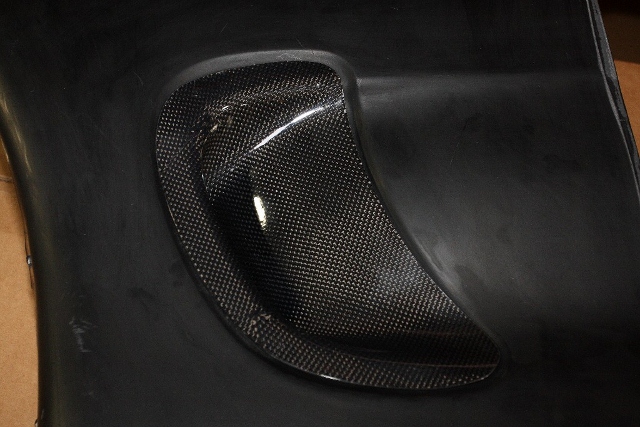

    • Shine Auto "Burnout" Widebody Front & Rear Fenders (not yet installed)
