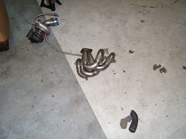

    Here are some pics of stuff we do.

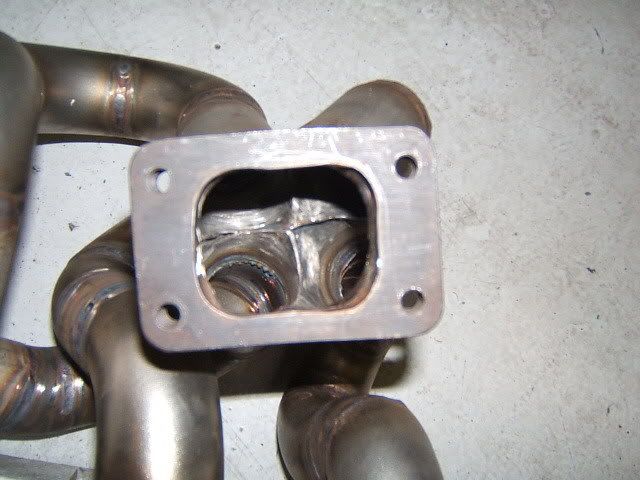

    This is a top mount T2 exhaust manifold for an SR20DET made of Schedule 10 stainless steel.
    In terms of manifold materials, stainless is the way to go for longevity and anti-corrosion
    I hand build all my collectors which I can adapt to any flange size or manifold set up

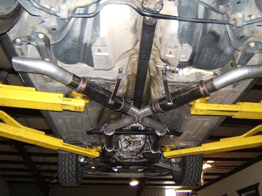

    This is the stainless 3" exhaust system /w v-band clamps for the LS2 s14 we did a couple months back.

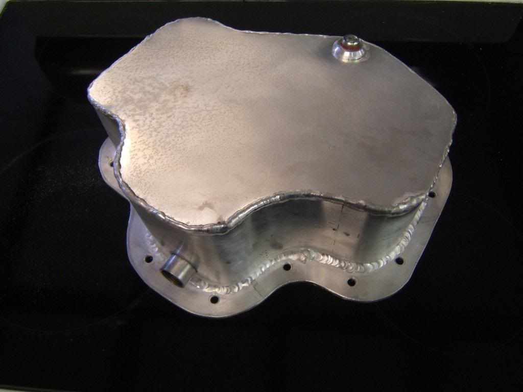

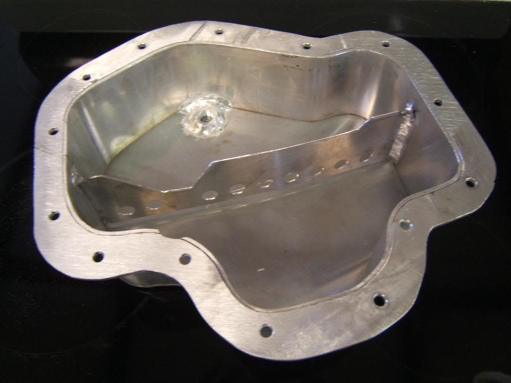

    here's the larger capacity oil pan. definately a need for turbo TC's

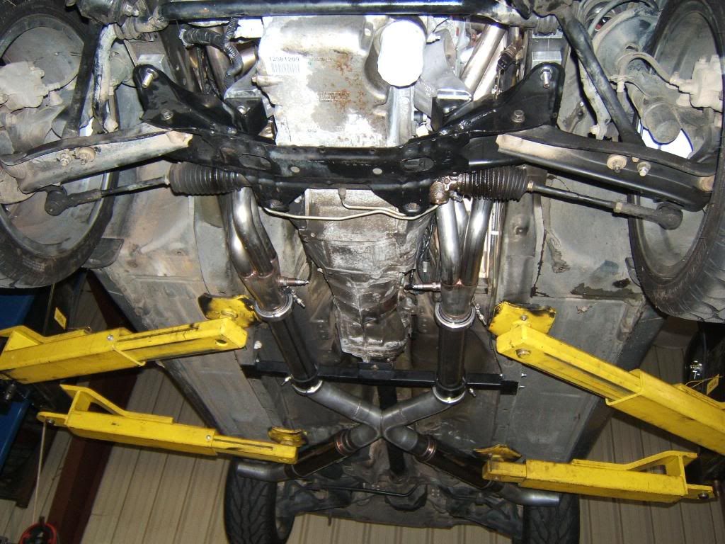

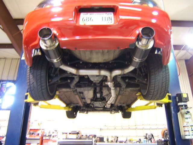

    here's the full custom stainless exhaust split into dual HKS Titanium tipped cans

    dude. you should not post poor welding skill like that on here. that manifold probably works great but man is that thing ugly or what? heat wrap that thing so we don't see that over heated welds. i bet the slags inside the runners are rediculous. learn to take your foot off the pedal to modulate the head. you are not dynoing a car here. no need for full throttle. drew or derrick should fire you for posting the pics of the manifold. admin, please do this man a favor and delete the pics.
    btw. if you want welding lessons, just pm me. i will be more than happy to give you lessons. we can trade off for some free dyno time if you feel guilty. exhaust system looks good. intercooler pipes can use some help. get a better saw to fabricate the parts will give you a cleaner weld. abrasive chop saw sucks. get a chop saw from evolution tool. it is call the evolution rage 2 and the cuts are fast and clean.

    nice! Chinabay turbo manifold looks nice than. It is not the material it is the welder that does not know how to control the hear with the tug torch. Go make another that looks nicer and replace the first pic with it. If you are going to advertise poor craftmanship like that only idiots will think it looks nice. Sorry for the tough love, but I don't want you to be like the morons on American idol that think they got skill.
    ultimate sleeper.
    Custom Finger Paintr Crosswyse's Avatar
    Sandy Springs
    why dont you stop by the shop sometime and show me how to weld, would love a lesson by the best.
    Mar 2004
    acworth, ga
    85
    i am not the best but i did enough to say that what you did is good enough. i have around 100hrs with tig welding. i know you can be better if you can get some critical advices. you need to move alittle faster with the torch or modulate the pedal alittle to keep the weld from being too hot. if you overheat stainless steel, it will look black because it forms carbide precipitation. you need to back purge the pipe to prevent crusty bumps from forming inside the pipe when trying to have complete penetration with the weld.
    try not to bevel the pipes too much because you will not be able to file in the groove formed by the bevels on the first pass.
    on steel intercooler pipes, try to cut the pipe clean and just melt it together with the torch because it will be so much cleaner looking. use a circular movement with the torch. you have to use really skiny filler rods if you want to fill the gap.
    get a gas len from the welding supply store. it has better gas shielding than a standard gas cup. it will make your weld looks cleaner. it is cheap too. around 3 bux. just break down your old torch and replace it with new gas len.
    you work too far out for me to stop by. you guys need to move back to marietta. come by with a tank of argon, a box of krispy kreme donut, and i will give you a quick lesson. guarentee to be 10x better after one hour. if i come out there you have to ask drew to give me some dyno time.
    go to ka24.org and check out the works done by other guys on there. some of them are amazing. it is in the welding section.

    That was my first manifold from last year to test fitment with shitty Stainless. And yes, material quality makes a difference when you are welding any material especially stainless and Aluminum. I will post pics of the latest one when I am done. I wasnt using a lens, no back gas, and just trying to get the penetration to test the manifold. I shouldnt have posted those. On all my other manifolds i back gassed, using a lens, and have perfect fit up. However i do bevel all my joints on the runners to get full penetration. I would much rather have the full penetration and it not look as good then a "pretty" weld that doesnt hold up. You really should work on giving advice before being an asshhole. It will work out better for you in the end. Most of my work before i got to lethal was in aluminum and mild steel of which i have 1000's of hours. I did do stainless, just not too the production level that i do stuff now. If you want dyno time, then call derek and tell him your coming to the shop to make me better cause i am apparently not very good and you want dyno time for it.

    now I got your attention. It not call being a asshole. It is call keeping it real. You should know not to post pics like that and not expect someone to say something negative about it. Be glad that I am honest enough to give you an truthful opinion. You should post your latest work and delete the bad one. I am keep on seeing excuses from you about the bad stainless steel. Stop that mess please. You are representing your skill and it is not a good representation with the manifold. It took me 30 hrs to be near great. Please show us what 1000hr means. I am pretty giving with positive opinion too.
    Btw, the oil pan can use some touch up too. It is easy to fix though. Go over it one more time so you can get that stacked coins look.

    i did this quickly to show that even poorly prep stainless steel can look decent. the collector looks nice because i took more time to make sure the beads are more even.

    Stop being so nice dave. It is guy like you that make me to be negative so we can balance out the force. Hahahaha.
    The down pipe is nice. The x pipe exhaust system is nice and is my favorite. I think Kyle can be much better if he got people like me giving him honest and knowledgeable opinions. Unfortunately some guys on import Atlanta do not know what quality is.
    Btw dave, did you guy check out the evolution rage 2 saw yet. It will cut fabrication time down a lot. It cuts so fast and clean so you don't have to waste time deburring the edges. It is way cheaper than a band saw. Cut way faster and longer than an abrasive chop saw. This is a must if you guy want to get serious about making parts.

    down pipe looks good. i know those pipes can be tricky to weld because they are thin.
    the pipes in the pic will work but for 1000hrs, you should be able to do better than that. please weld another one with a more evenly spaced bead and post it for use. try focusing on the weld puddle a little more. imagine shifting the puddle a 1/4 of the way forward and then feed it with the filler rod. have the filler rod about 1 cup distant from the weld puddle. this way you can feed the filler rod at the same time along the weld line. there is no shame in stopping and starting a new bead line. i know what i said pissed you off pretty bad which can make you loose your focus. just be cool.
    consider my negative comments as mnemonics which will help you remember to be on top of your game. if you want to do works exlusive for riceboys, then it would be okay to stay at your level of welding skill. i know i can be a lot nicer, but that would not get your attention. you have the skill. you just need an asshole like me to bring it out.

    they are good for 700-1000 cuts. I know the 14in blade will fit on a regular chop saw, but the evolution saw is special by itself. The motor turns slow which keep the blade and cutter material cool. I was thinking about getting just the blade and fitting on my abrasive chop saw. I think if you don't put to much pressure on the blade it should be fine. I will try it and let you know. This saw should help makes the collector so much easier. The cold saw is nice but a little messy for exhaust work.

    Keep the chop saw to bevel the pipe. I like to get a nice belt sander to keep the dust down.

    Btw, what kind of welder are you using. If possible, get a watercooled torch because it is so much lighter which give you more control over the torch. I have a standard torch right now which is pretty heavy at time and want to tilt out off angle when I weld.
    ultimate sleeper.
