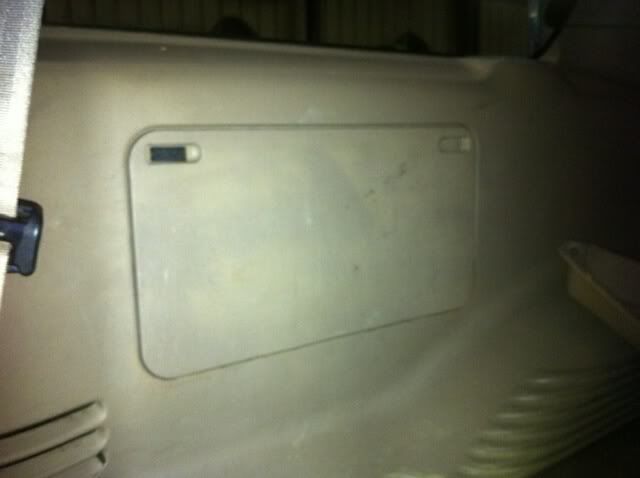

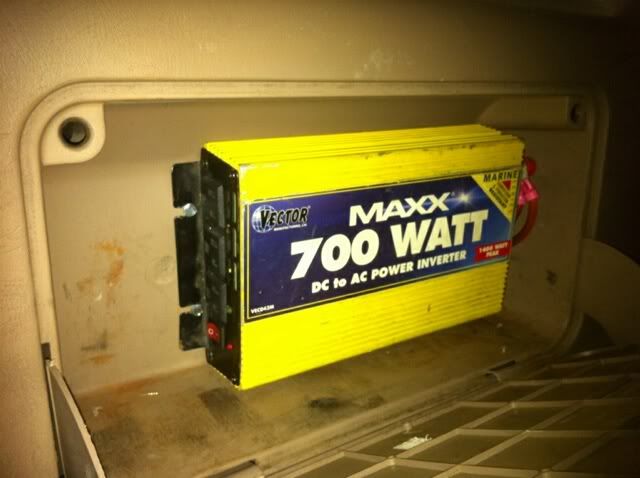

    converter installed
    cant even tell its there

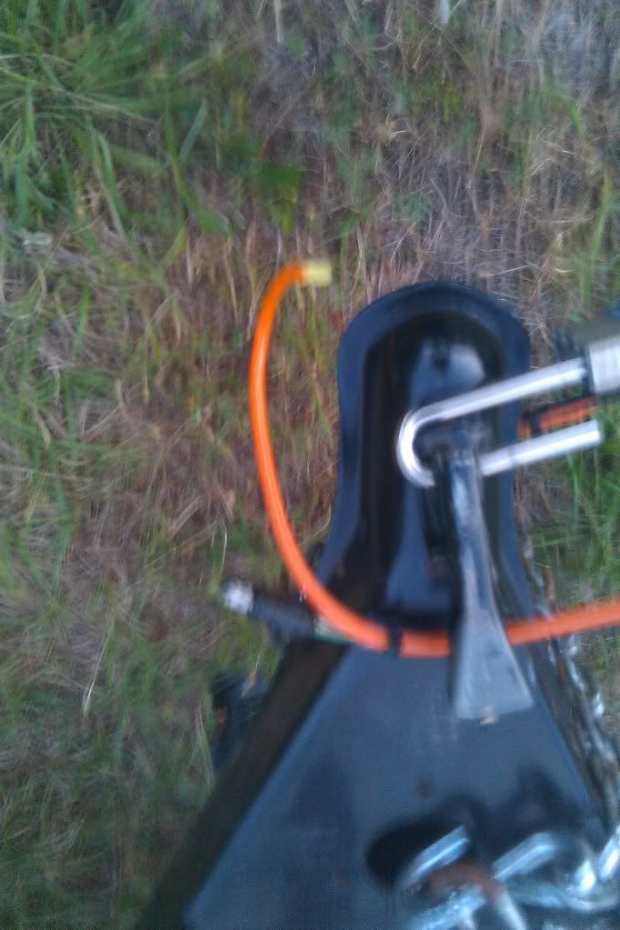

    hook up for trailer (8 guage wire)

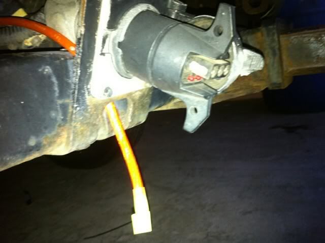

    hook up on trailer. wire is run from batteries in box on trailer.

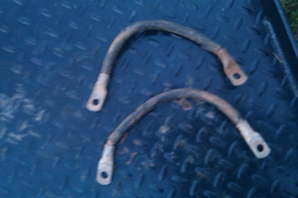

    what i used to hook batteries together in box on car trailer
